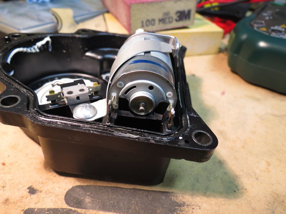

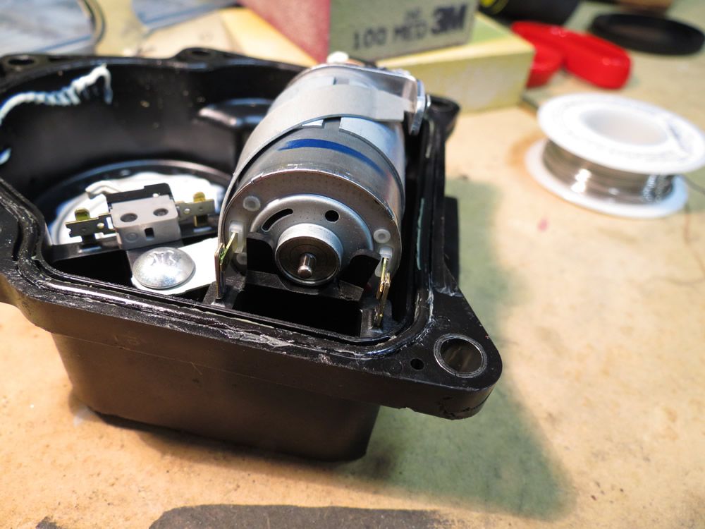

I got a new take off from Just Differentials, you can't beat the deal, plus they have great customer support
Make sure you solder the internal connections before installing the new ADD, they are only pressure fittings.

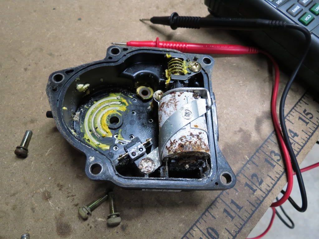

My ADD was toast, sand and water go into it, not sure how which is concerning.
