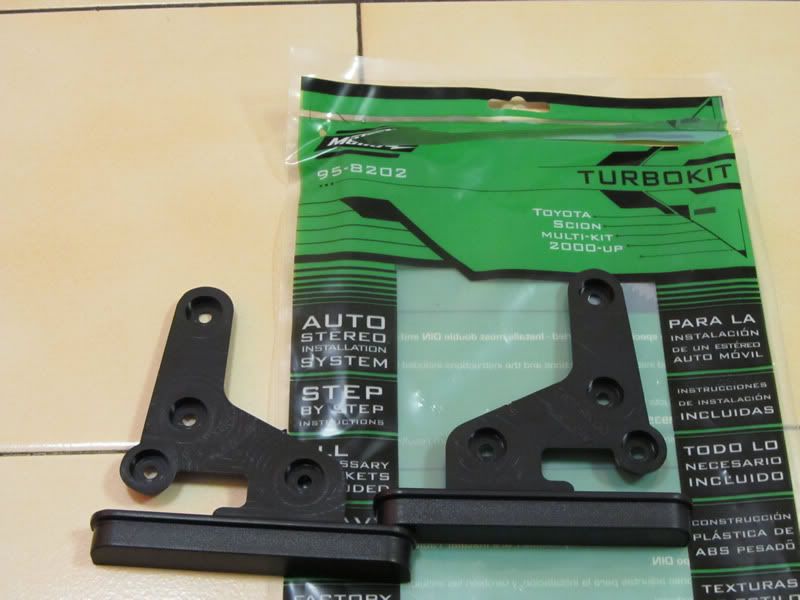

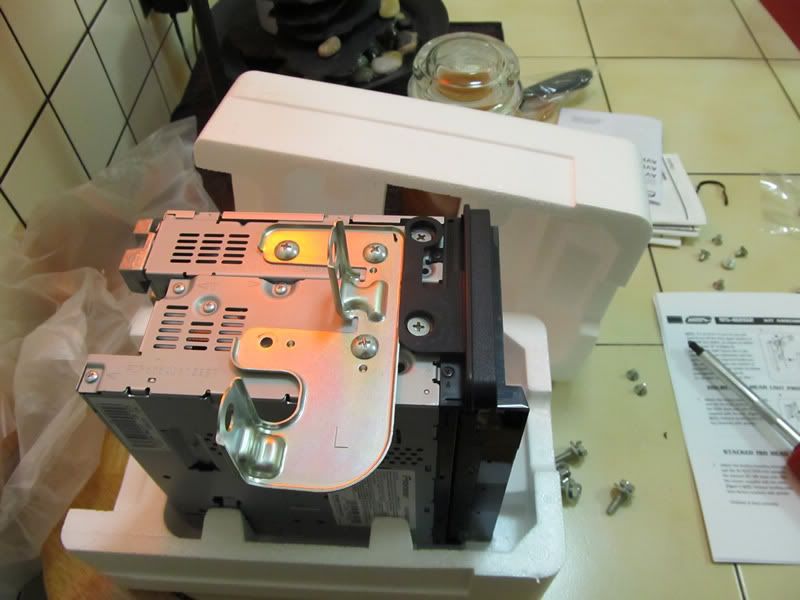

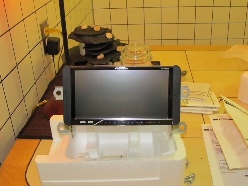

Metra Kit, many complain they don't like the fit of the Scosche, also if you have a moving screen the Scosche definitely won't fit.

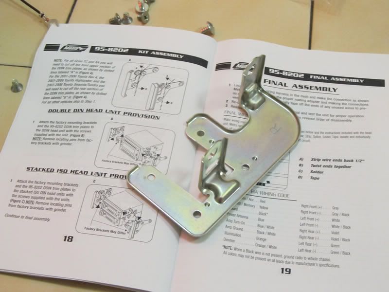

Remove the Double Din Bracket from the FJ stereo
If you want to bypass the movie playback protection while driving, you will need a relay.

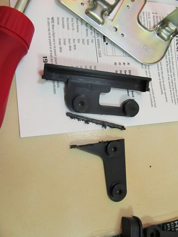

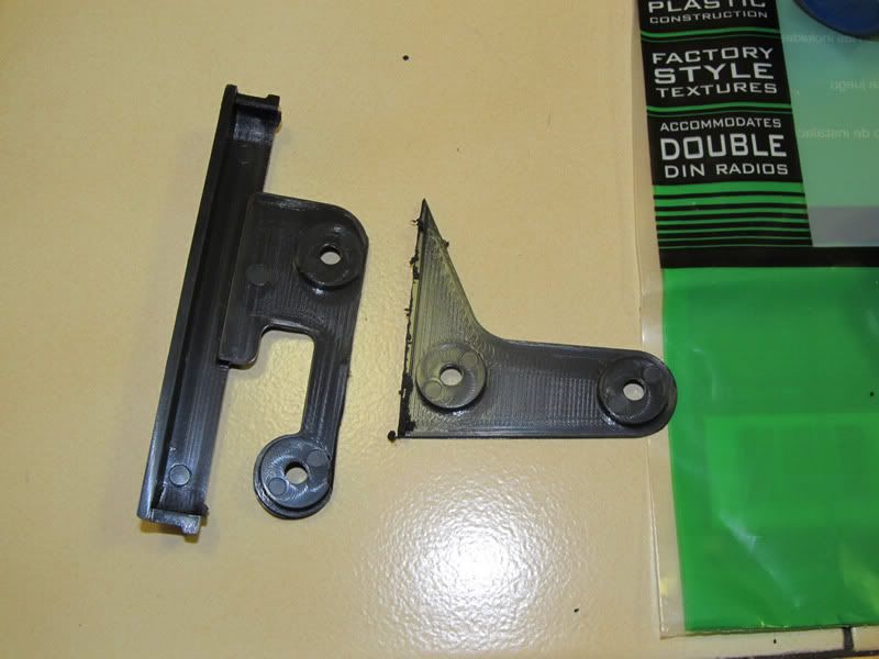

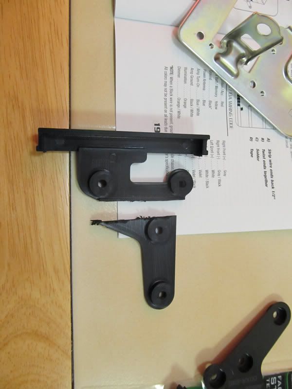

Metra bracket needs to be trimmed for FJ, instruction do not tell you this
Left side Bracket, First cut was not enough
2nd cut
Perfect
Repeat for right side

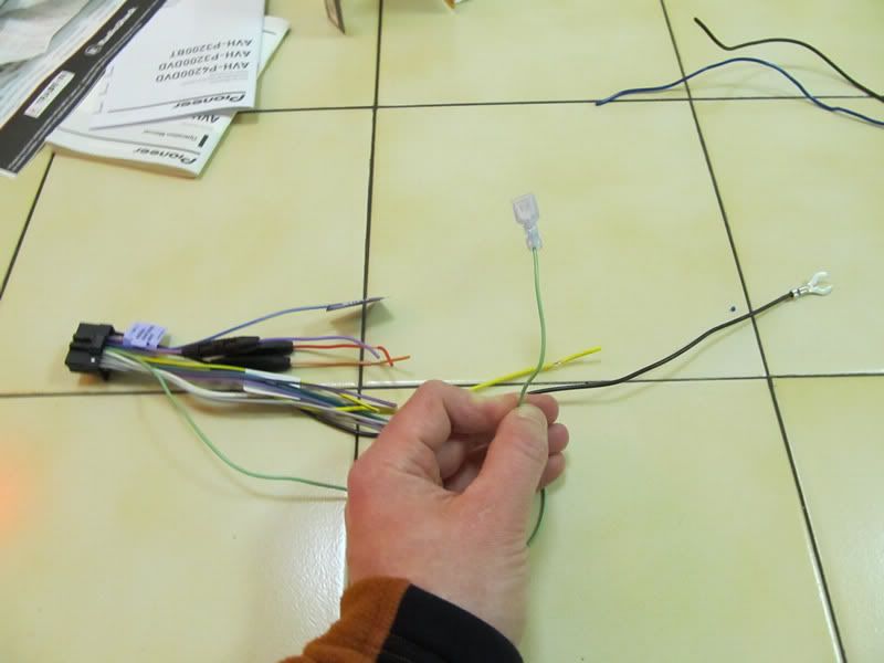

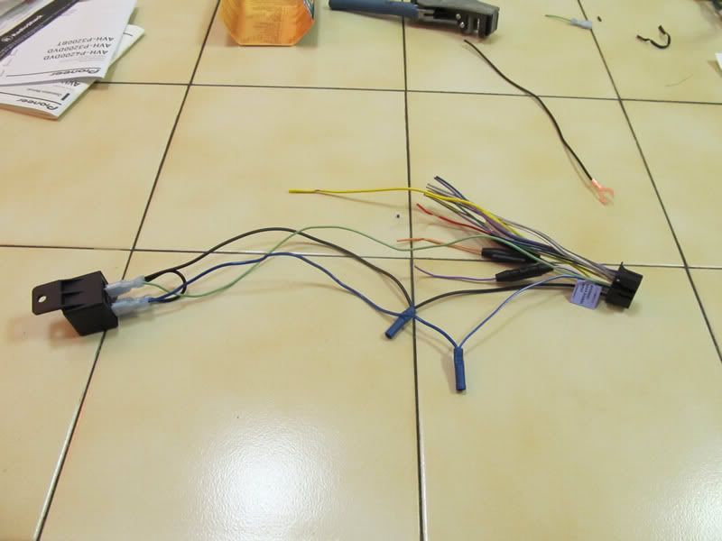

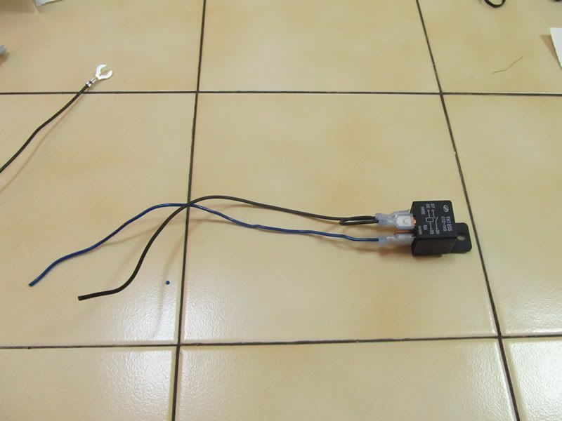

DVD Parking Brake bypass with Relay as instructed here
YouTube - Pioneer AVH-P4200DVD Bypass & AVH-P5200DVD Bypass
Attach a female spade terminal to the green wire (Parking Brake) on the Pioneer Wire Harness
Relay attached to Pioneer Wire Harness. The blue wire butt connector will be attached to the corresponding blue antenna connector and the black wire butt connector will be attached to the corresponding black ground connector on the Metra or Scosche wire harness
