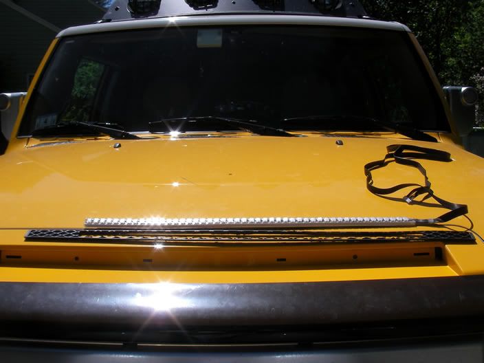

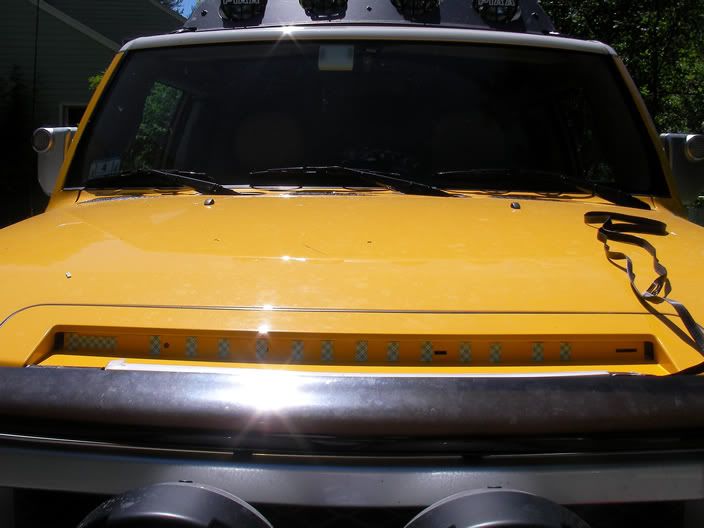

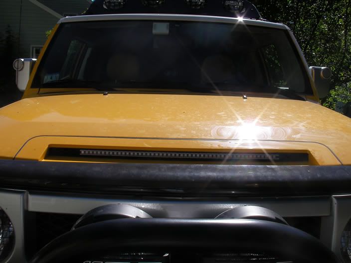

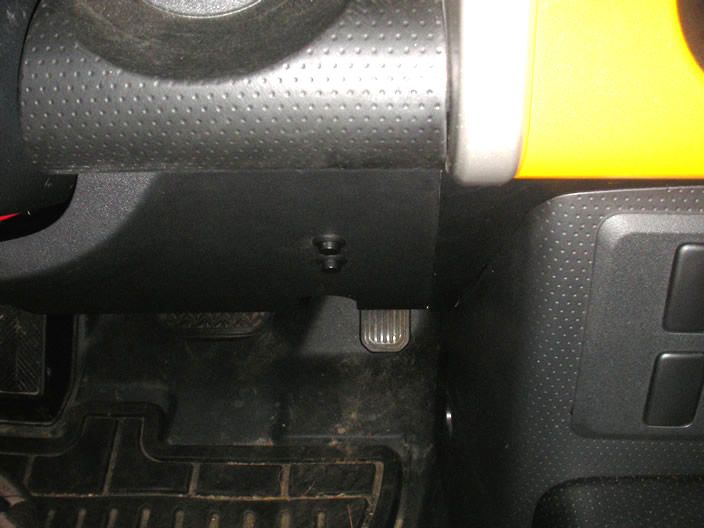

Here's my version of the install, I wanted the LED strip to be more integrated. I cut the strip with my dremmel.

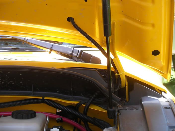

The controller box is not water proof or even sealed. I wrapped window heat shrink around the box and hit it with the heat gun. A sticky strip to mount it to the frame, the wire harness is long enough for it to reach here. I also wired it to the fuse panel and installed a switch, the remote would not hold up long with constant use.
Video
Switch
